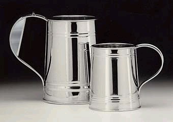

Ideal for model Tin-ware Trains, antique tin-ware, Cooking Utensils, Electronics, Buss Bars, Tools and much more
